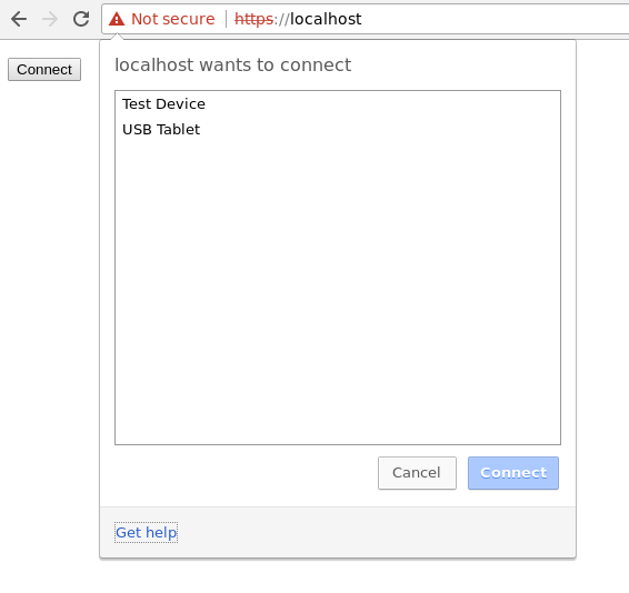

A web page can request permission to a device which opens a prompt. It must specify a filter on how the available devices should be filtered. This filter can be empty allowing to let a user choose a device from all available devices. The prompt opened looks like the following:
The user can see all (filtered) available devices. The devices are referred to by the product name sent by the device. If no product name is specified Chrome tries to guess an expressive name with the help of the known information about the device. It then names the device for example "unknown device from <vendor_name>". After the user selects a device and clicks "Connect" the permission to access the device is granted.

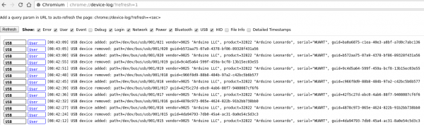

Although the GUID is a unique ID it is not used for identifying the device. Below is a screenshot from the device log after plugging in and out used test device for multiple times. Each time the device has another GUID. It is however recognized and accessible without the need for further permission requests.
This suggests that Chrome uses a combination of Product ID and Vendor ID to identify a device.

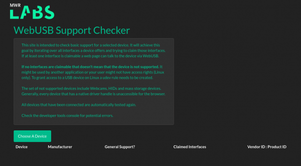

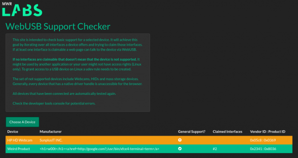

A small proof of concept tool was constructed that can easily determine if a device is supported by WebUSB. The tool tests if it is able to claim at least one interface of connected USB devices. That means that it is able to talk to the device and therefore it is supported.
The tool cannot test if a USB device is completely unsupported – there are different reasons for not being able to claim an interface. The interface could be claimed by another program or the browser might not have access rights on the system (Linux).
The tool is a simple static site. You can download it here. This is how it looks:
To test support for a device, click the "Choose A Device" button to open the permission prompt. This prompt lists all available USB devices. By selecting the desired device and clicking "Connect" the tool will then open the device and iterate over every available interface and trying to claim it. The results are recorded in the table at the bottom of the page. The claimed interfaces column displays the interface number(s) that could be claimed.
 If you want to use the supported devices elsewhere you will need to refresh the site or close the tab.
