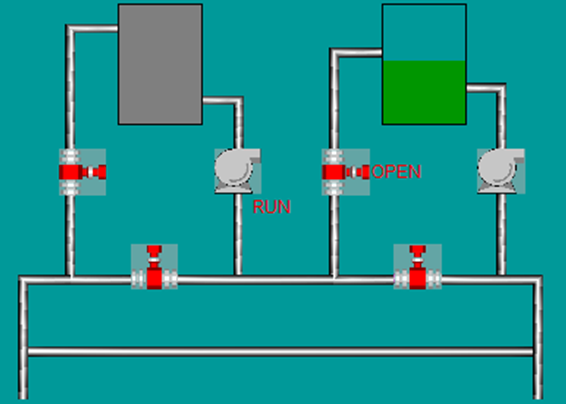

SENAMI was specifically developed using Lancaster University’s Industrial Control System testbed. This is a diverse system, but it is was the water treatment and distribution capability and their controller S7 PLCs which were used.

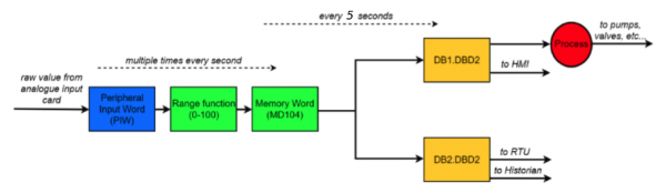

Specifically, SENAMI monitors 3 values that are integral to the way a Siemens S7 PLC’s memory is generally configured. This specific configuration can allow for an attacker to disrupt the monitoring – i.e. overflow a water tank, while showing to a user remotely monitoring the level that everything is normal. This sort of attack was what was used in Stuxnet (except with nuclear centrifuges instead of water management). It’s important to note, however, that the choice of these 3 variables is highly context-dependent and only applicable if a given S7 PLC has its memory configured in this standard way:
The above diagram shows the internal memory configuration of a Siemens S7 PLC. The analogue value is read in on the left (and stored in PIW) and has a digital range applied to it (say 0-100) to produce the value in MD104. MD104 is what should happen. This value is then copied into 2 different data blocks: DB1 and DB2, and this is where things become insecure. DB1 is used to affect the physical process – so this is what is happening – while DB2 is used for monitoring – so this is what we’re told is happening.
These 2 values are established for a separation of duties; if we have hundreds of devices reading the current value, only one needs to be misconfigured and write to the value to accidentally damage the process and break something. However, if these devices are reading from a separate but equal value, and accidentally write to that, all that happens is a temporary monitoring disruption. So DB1 is intended to be a more protected value, which is the absolute value of what’s actually happening (although obviously it’s not actually anymore protected than DB2).
So, it’s a sound idea. However it introduces – by its very conception – the possibility of a discrepancy between values. So if an attacker could, for instance, write to DB1 telling it to fill the water tank, and write to DB2 saying the level is in the middle of the tank, an operator would see things as normal even while the tank was overflowing. This is shown in the RTU (Remote Terminal Unit) screenshot below:
What makes this even more dangerous is that it is possible to directly write to these data blocks and for the PLC to actually affect those changes. So, while in Allen-Bradley PLC systems, for example, an attacker would need to rewrite logic code to perpetrate this attack as well, with S7 an attacker can use a simple Python script with no changes to the logic code.
These Python scripts can be trivially small and invoke legitimate Write packets (a specific packet type within the proprietary S7 protocol), specifying a certain PLC variable (e.g. DB1) and a certain value. These messages will then be acted on by the PLC; this forcing of values means any attacker with access to the ICS network or direct access to the PLC can perform the “value tampering” attack to disrupt monitoring described above.
And if an attacker has a compromised IP and is masking traffic in expected-busy periods (as discussed earlier in this article) they could easily evade detection by a passive IDS. SENAMI, however, monitors the values of MD104, DB1 and DB2 for certain discrepancies, and detects these value tampering attacks with 93% effectiveness (with a combined passive and active detection rate of 81-93%). This includes a few False Positives, but crucially very few False Negatives – i.e. it very rarely misses it.
