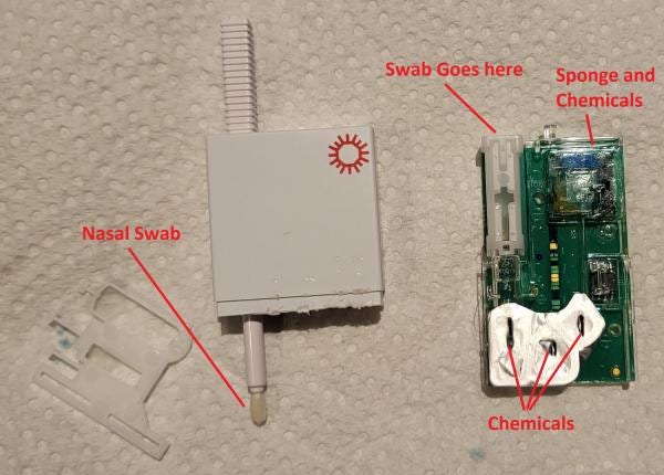

Before diving into the technical details, we will give a brief overview of the test components and how it works. Two components are required to take a COVID-19 test by Cue Health, the Cue Reader and the Test Cartridge.
The Cue Reader unit contains a heater, gyroscope, and the necessary hardware to communicate with a user's phone via Bluetooth. When taking a test, the Test Cartridge is inserted into the Cue Reader and the test itself is conducted within the Test Cartridge. The data is then passed to the reader, which is then transmitted to the user's phone.
Each COVID-19 Test Cartridge comes with a nasal swab which is inserted into the cartridge. The Test Cartridge contains liquid which is released when the nasal swab is inserted, and gathers in one area in the cartridge where the test is conducted.

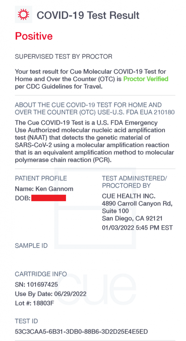

Below is a picture of the certificate obtained by WithSecure after the test was taken:
