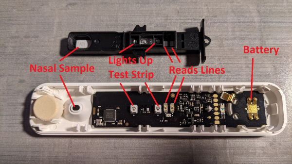

The analyzer itself was a custom board and a standard Lateral Flow test, with the custom board determining if the user was COVID positive or negative. This determination is based on what the "two lines" look like on the Later Flow test strip. The analyzer would then inform the companion mobile app if the user was COVID positive or negative.
On the board is some LEDs to light up the test strip and some lens to read the test strip result lines. A hole on the case itself can be used to put the nasal sample on the test strip.

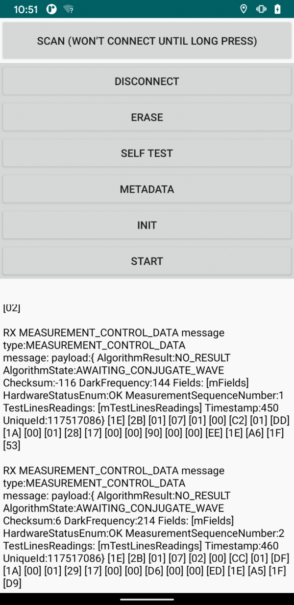

The Android application contained an un-exported activity called "com.ellumehealth.homecovid.android/com.gsk.itreat.activities.BluetoothDebugActivity". If you have root level access to your device, you can launch this activity to help interact with the analyzer over Bluetooth.
Using this activity, WithSecure deduced that there were two types of Bluetooth traffic that were most likely in charge of informing the mobile app if the user was COVID positive or negative:
  • STATUS
  • MEASUREMENT_CONTROL_DATA
Below is an example STATUS message:

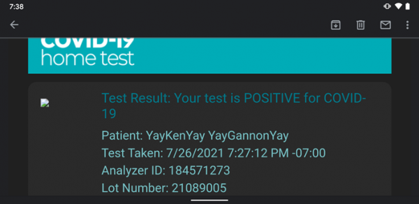

Below is a screenshot of an email from Ellume confirming that the above COVID test was a positive test:

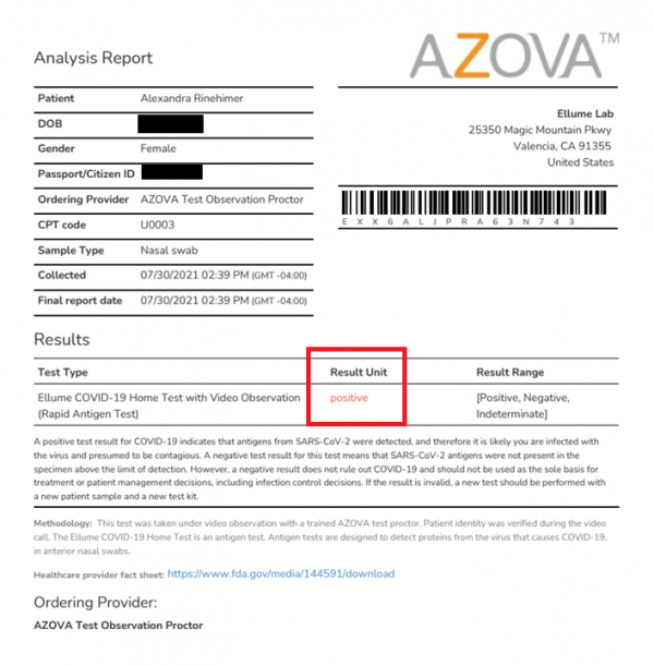

Obtaining an Azova Certificate
At the time of this post's publication, the United States requires a negative COVID test, and the Ellume test is one option to provide proof of a negative test. If a customer chooses this option, they are required to have their test observed by the third party company Azova. To prove that WithSecure could fake a positive COVID test and obtain a certificate from Azova, the WithSecure Marketing Manager Alexandra Rinehimer took the COVID test while being supervised.
When it was time to take the test under the supervision of Azova, Alexandra used WithSecure's Xposed Module PoC. After launching the Ellume app with the Xposed Module, Alex proceeded to take the test. Below is the output log from the test, showing that while analyzer 151131494 reported a negative result, the Xposed Module changed the result to positive:

Below is the certificate that Alexandra was given from Azova:
