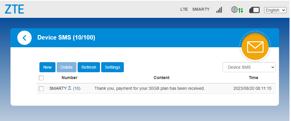

When SMS messages were viewed through the LTE modem's web interface, a request was sent to the following URL: http://TEST.DEVICE.IP.ADDRESS/goform/goform_get_cmd_process?isTest=false&cmd=sms_data_total&page=0&data_per_page=5&mem_store=1&tags=10&order_by=order+by+id+desc&_=1692870779000.
Which returned a JSON array containing SMS messages sent and received on the device.
